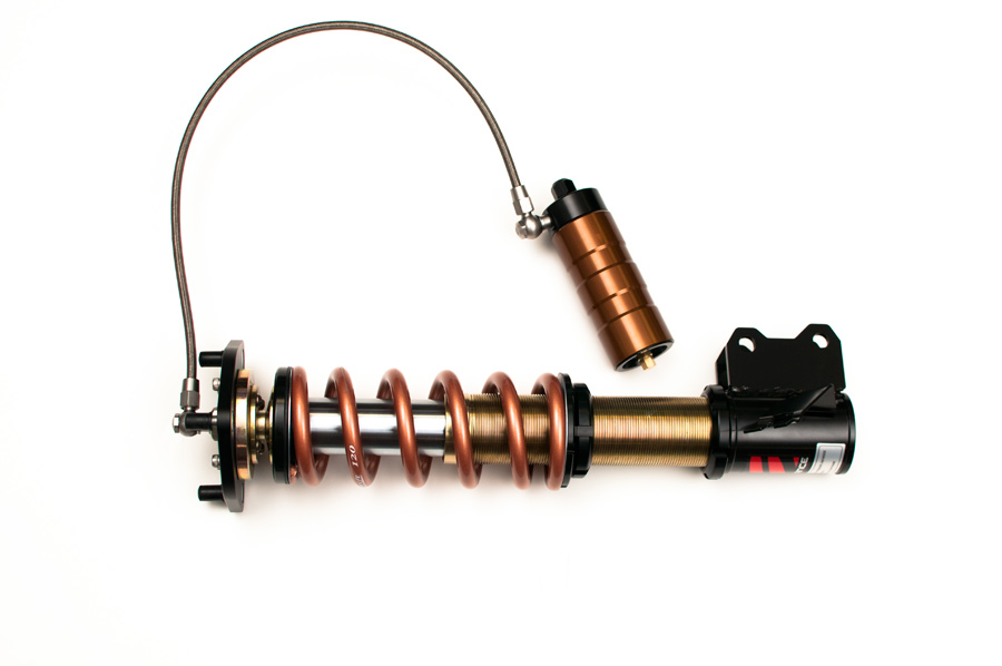

Custom valved S13 GR+2way for a customer we just got.

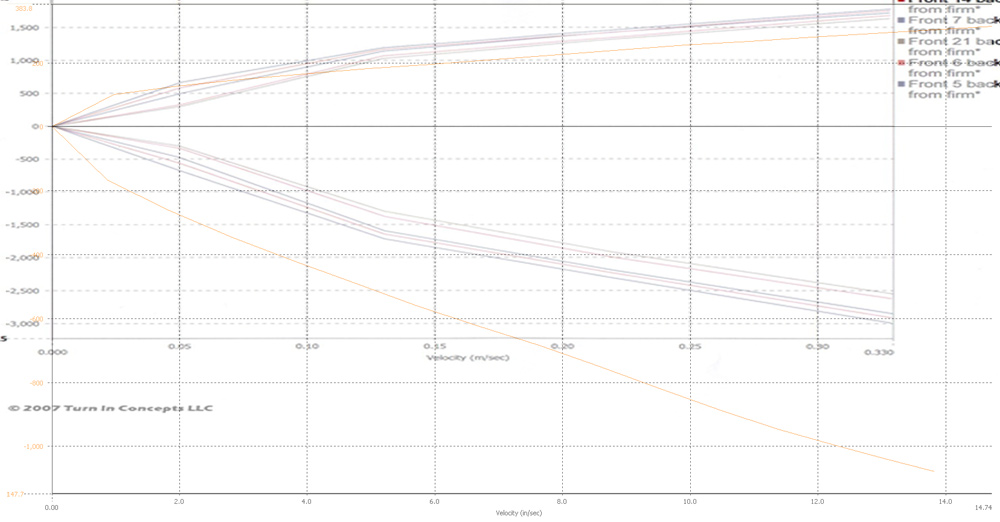

Are there any shock dynos of these competition level Stances, because the last Stance dyno I saw was no so good.
I would love to see an explanation as to how coils play a factor on a dyno. Moreover, I don't really care about the dyno or numbers... I care about ET.
Note, he said SHOCK dyno. Do you know what a shock dyno is?

Ummm... twin tubes WERE used in F1, Indy etc. in the early 80's and earlier before they went to bellcranks and needed a monotube for mounting purposes.
I've seen the inside of both a Stance GR+ and a lowly Koni yellow. The Stance is absolute GARBAGE in comparison (needle type foot valve rattles around, cheap plastic bushing, far too linear shim stack).
There's a reason you can get a replacement Stance damper for less than $100, and it's not because they're selling them below cost out of the goodness of their heart.
Nevermind that shock dynos show Stances to be laughably weak at low piston speeds and far too linear. They feel that way too, harsh and crashing over any sort of bump when you've got any amount of low speed damping, and as bouncy as any other cheap Chinese/Taiwanese damper at the lower damping ranges.
Nevermind that the "clicks" are a ton of holes drilled in the bottom of the adjuster and a spring loaded ball bearing to give you "lots of clicks" that do almost nothing once the needle valve is much off the seat.
Anyway, I'm really sure the Stance guys have actually had lots of experience with an 8611/8610... haha

Stance's target customer has never heard of a shock dyno. Sounds like the sale has been made... $70 "superior" monotube dampers dominate the guys that have been making dampers for all levels of real racing for decades!!!

No, there isn't any shock Dynos. They claim to have them, but it's "confidential" so they won't post them. As if someone is going to look at a shock dyno and copy the damper design. Obviously the hard part isn't knowing what a shock dyno should look like, it's getting one to perform properly.

Here's a dyno comparision of Stance S13 Front for 8kg/mm and Ohlins WRX Front for 7kg/mm. Stance is Orange.
I had to stretch the Ohlins dyno for scaling reasons. For reference 1000N = 225lbs , .10 m/sec=4in/sec.
Note: Rule of thumb for valving - Lower spring rate = higher comp force, lower rebound force. vice versa. Hence Ohlins higher comp and lower rebound.
Notice the excellent low speed rebound and compression range on the Stance. Similar digressive curve for the compression for good high speed bump.
On the rebound, the curve is almost identical until the Ohlin's second knee, which is the DFV working. Pretty koo.
